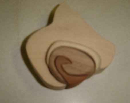

    here is my first attempt at fuming some Cherry...the piece was fumed over night and I was hoping it would of been a little darker..
    this is how I fumed the piece...
    this is the result...it looks darker in the picture...
    maybe I need to use a better grade of Ammonia rather than the cheap stuff that I bought at wal-mart for 98 cents....
    that is an ingenious fuming tray.
    I always thought those little pizza savers were only good for doll furniture!
    I wonder if heating the ammonia would speed things up.
    Maybe putting it under a lamp may help.
    If you want a source of stronger ammonia you may try a refrigeration repair shop. I am not sure if "blue prints" are still common, but that would be another source.
    It is getting harder to access though since it is commonly used to make crystal meth!

      There is a posibilty, that some of the woods you used will not fume as well as others.
      You also, may want to try making up some "tannin tea" and then brushing it on the woods (soak some teabags in hot water)
      Naturally, stronger ammonia will work better then the household ammonia, to get the best results at fuming is to use woods that are high in tannin.
      Keep experimenting, its only your first try.
      Good Luck
