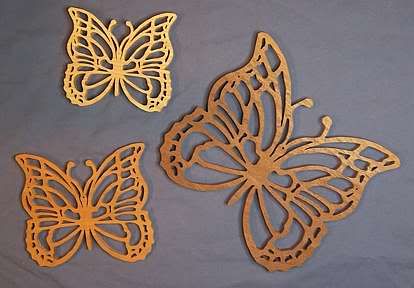

    Niece has registered a butterfly pattern for her and future husband's serving dishes. To match basic platters and serving bowls, I made the following from a Patrick Spielman's pattern (walnut, cherry, ash):
    Expect dishes at about 350 degree F (180-190 C.) This will cause many finishes to discolor due to heat. Also have to expect food spillage on finish.
    Checked with reference book I have, and it suggests avoiding BLO, Danish Oil, shellac, and Cell. Nitrate Lacquer for this application. The best is Conversion Finishes such as Pre-Cat. Lacquer, and so forth. Looked these up, and no way am I using these in a closed basement environment. MSDS for pre-cat lacquer some what on the somber side.
    I should add I am a lacquer snob, and am very much a shellac and lacquer chauvinist. I haven't stooped to straight poly varnish in about 10 years.
    However, the heat problem leaves only spray poly for option(s). Have looked, but options too many and no label gives info for such applications. I have no idea about the water based fast drying varnishes and how they would work in my air brush. I keep reading that the resin molecules are quite large and have a problem with HVLP systems. If HVLP has problems, my poor air brush will have fits.
    Any advice?

      May I ask where in the world did you hear not to use BLO or Danish oil. I ask this because the 20 something years I have been scrolling I have made countless collapsible baskets and they can be layed flat and converted to hot plates and have made them out of oak, maple , mahagany and finished them all with a coat of Danish oil and have never had one come back to me with a complaint. Others I know also do the same thing. You could always leave them natural and use a olive oil or such . Such as cutting boards.
      John T.
        JT:
        Bob Flexner's book "Understanding Wood Finishing" Rodale Press 1994 edition.
        Entire chapter 13 deals with finish selection. Looking at 'Heat Resistance' of finishes: All oil based finishes, (BLO, Walnut, Danish, tung, etc.) rated a 3 (out of 5). Shellac rated 1 and Wax rated 0. Water based finishes (1994 only had new WB lacquer on market) and Nitrocellulose Lacquer both rated a 2. Most varnishes rated a 4. Conversion Finishes and some Polyurethane finishes rated a 5 (the best.)

                OK Phil I see you sort of answered your own question. I went back to reread your initial question and I guess I do not understand it. So in that case I will butt out. I will say this I will continue to finish the trivets off the way I have been and feel good about it. I guess a 3 out of 5 is not that bad because I am just an average guy. Good luck in your quest for the right finish. I gues I need to reread Bob's book again.
                John T.
                  John:
                  Please don't butt out. I am not a finishing expert. I am asking for comments and advise. Your opinion on using oil based finishes is valid.
                  Since I was doing a trivet in wood, I looked up some reference on finishes and heat. You saw what I got. I checked with some people who had solid wood trivets and their trivets all had darken spots. I could not tell if the darken areas were caused by heat, acid food spills, natural aging or what.

                    Not a problem but sorry I can not help in this area for I have never used the products you have mentioned. I know I am going to open a can of worms here but have to ask how thick are these pieces?? The reason I ask I forsee a problem with the antenni. Look fragile for a pieces that will be handled alot. Plus the wiping and such. Just a thought.
                    John T.
                      The height, or thickness, ranges from 3/8 inch to 1/4 inch.
                      Yes, the antenni are fragile. They most likely will break off at some point in time. If my niece ever decides to have kids, well.... let's just say I do remember her during the 'terrible two' year (plus a few months) and payback is coming according to my sister.
                      Just the way I choose to layout the grain direction, either the antenni are weak or where the body meets the wings. I flipped a coin.
