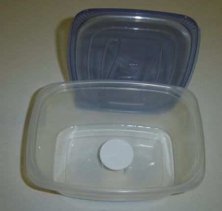

                      Fuming faster
                      Hi Trout,
                      Lesson #2 "A faster way to fume"
                      As you know fuming takes time, here is a second way of getting the fuming colors much faster.
                      "Please wear all your personal protective gear before you get started".
                      Instead of the tent, box, or whatever your using to fume in, just take your ammonia and wipe it directly on the wood, to control the colors just dilute the ammonia with water. You will need to do some testing.
                      As always, whenever your first working on any finish, be sure that you make up complete start to finish samples including your clear coats.
                      Mac
                        This should make it easier to understand.
                        A picture is worth a thousand words.
                        I hope this helps.
                        Mac

                              I think, these 2 photos tell the story of how you can color your woods by wiping or brushing on the ammonia.
                              Be, sure you wear your protective gear.
