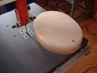

    A router mounted in a table with a template follower can be very useful, especially when making name plates and signs. I've found that cutting ovals is very difficult so I bought some wooden blanks from a craft supplier that I use as templates. First the template is fastened with screws to the two pieces of board which will be used to make the sign, then roughly cut to shape on a bandsaw:

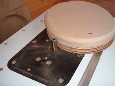

    Then the whole is shaped on the router table:
    The template is removed and both boards, now identical ovals, are separated. Of course, the screwholes pass through the board which will be used as a backer and into the front board, so realigning them after the motif is cut out of the front board is a doddle:
