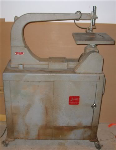

    So now I have 3 scroll saws. 1 enormous J-Line which is non-functioning due to irreplaceable parts and destined for the scrap yard
    (the base and motor are being recycled, but if anyone has a use for a huge hunk of cast iron scroll saw, let me know). Then there's the Delta 40-690 that I bought last year. Nice saw, like it. I sold the base out from under it and put it on the J-Line base. Then there's the Hegner 22v that I bought yesterday from a woman that bought it new 13 years ago and hardly used it. She said the blades broke too much and it made a noise that scared her. After examining the pristine saw (with a less than pristine base- peeling paint and rust on the bottom of it) I concluded that the problems were user error. This is a very nice saw.

                      That's what she looks like. As I said, I'm planning to recycle the base and motor. I suppose if someone were interested in the whole thing I would consider letting it all go for what I have in it.

                        Nope, that would be a bit of a trek for me. But I would hate to see it go to the scrapyard though.
                        There is a large subculture of old woodworking machine afficianados who would more than likely be interested in it, even if just for parts.
                        Here is a link to the OWWM (Old woodworking machine) website, specifically their classified section called BOYD (Bring out your dead).
                        Old Woodworking Machines • Login
                        I would be willing to bet there would be someone in your neck of the woods who would be interested, especially if the original stand (maybe motor too?) was with it.
                        All original stuff like that gives many people goosebumps.
                        -Richard-
                          I had gone to OWWM looking for help when I first got it, but the machine was sufficiently obscure that nobody knew anything about it. J-Line was a trade school brand that, I gather, wasn't hugely popular. But I'll pop into the link you posted and ask around.
