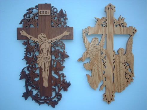

          Here are a couple of crosses I made. The cross is walnut and the Angel is oak. Both 5/8" and a FD #5 blade was used. By the way if you want to try the Flying Dutchman blades the site is wwwmikesworkshop.com Mike will send you some free samples and is a very nice guy to talk to so he can help with blade selection. If you check his web site out he has alot of useful info there.

            Beautiful work John!!

              Just wanted to say that your crosses are great.

                John - those are fantastic. What size are they? Are the lines in the angels' robes cut or burned or what?

                  Nancy-- the aproximate size of both is 9" wide by 15" tall The angels robes are all scrollsawn cuts or veining like it is called. Of course like with any plan you can make to any size you like.
