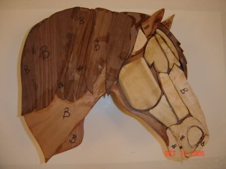

    here is my version of Judy Robert's Draft Horse..
    I started the project September 18 and I just finished it up today October 14..
    I'm pretty please with the way it turned out...
    It's cut of 3/4 cherry, walnut and basswood..
    The new technique that I tried on this project was fuming wood with ammonia...
          Hi Trout, that is one beautiful project. Can you tell us what parts you fumed? I especially like the way you oriented the wood grain through the mane, it looks like the sun is shinning on it. After it is all cut out and finished, do you glue it back on a backer board cut to the exact shape?

                  as for the fuming...there are 5 pieces that I fumed.
                  the first piece is in the middle of the nostril which darkened the most because I fumed it over night.
                  the other 4 pieces are the inter ear, the bottom of the cheek and 2 on the neck. these didn't darken as much because they were only fumed for a few hours...I was on a 12 hour roll to get this project done...
                  as for a backer board...
                  I don't use one...all my pieces are glue together piece by piece with 30 and 5 minute set epoxy....when done I'll coat the whole back of the piece with epoxy filling in any gaps.
                  "knock on wood" I haven't had a piece break apart yet....
