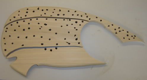

    this is a tip that come with the steelhead trout pattern that I did..
    this was too cool and it added a great touch..
    #1..using a small bur bit on a Dremel tool, bore a random pattern of shallow holes about 1/16 deep...
    #2..for black spots, mix sawdust with ebony stain and let "DRY".
    then mix the dark sawdust to a small amount of 60 minute epoxy...
    #3..use a toothpick to fill in the holes and then allow the epoxy to cure over night..
    #4..sand smooth and then finish..
    I wish I had been more familiar with the process at the time because my spots needed to be a little bigger..
    BTW..this peice was sent up north to a buddy of mine that I steelhead fish with..

              Trout for sure, thats a great tip. wish i would have thought of that. ok now what about the scales. do you have a tip on that one. it would be fun to feal the project. not wood burning though. something like.mmmmmmmmmmm wish i had a idea. I know trout don't have scalles. not that you would take off anyway. haha. but i still would like to know on some others like tulapia. like i can spell that. ha. your friend Evie
                Hay trout. i had another idea. have you thought about puting some stain on the tooth picks. and after inserting them sprits it with some water or oil . just to let alittle color come out. before sanding. mmmm. just a thought. yoru friend Evie

                    If you have a woodburner another way to do it would be to use a ball tip on a woodburner to burn the black spots. The tips come in 5 sizes and the spots would be more uniform...if that's important. It might save some time and is fun to do.

                      I like that idea...and the trout looks cool too. I would have cut out every dang spot on the fish and inlaid wood into it, but now you have me thinking.
