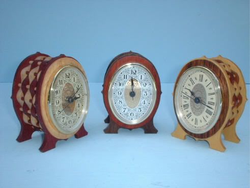

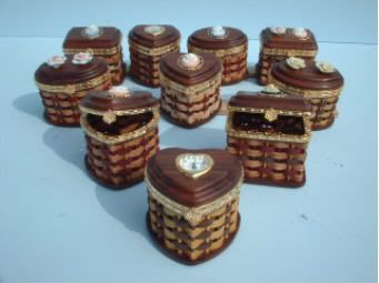

                Welcome and glad you got things worked out with sign-on. I would like to take a stab at your question on glueing. First let me say I use yellow or brown carpenter's glue 95% of the time on my projects. The method I use when I want to glue an overlay is as follows. I take a small amount on a scrap of cardboard and take a sponge and dab into the glue and dab the cardboard a little then dab the back of the piece. The idea is not to have too much glue on the sponge. The stipling effect gives it good holding power. and it does not run out the sides. But when dabbing the back of the piece do not dab too hard just enough to get the glue on. Works great.
                The other thing with the baskets I again use yellow carpenter' glue. Many scroller's prefer Aleen's Tacky glue which can be found in any craft store.They like the brown bottle. You can also use the crazy glue or super glue but beware these set fast. What I do is put some glue on a piece of cardboard and use a tooth pick to apply the glue to the contact points so I can control the right amout of glue used. I will try to post examples because it works for me and is easy to do. If you need more explanation I will try.
                [img][/img][img][/img]
                The top clock shows an overlay piece with a backer piece glued to the main body. The keepsake boxes show layered scrolled pieces.
                John T.
