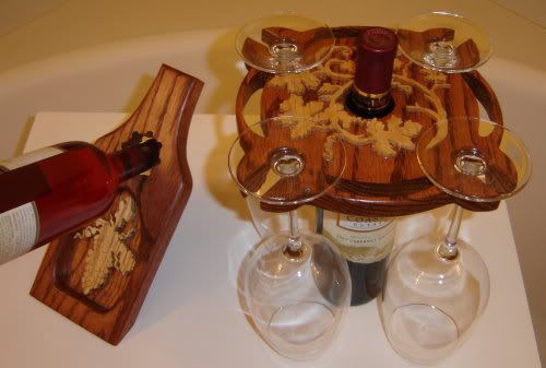

    The first set will be given away tomorrow to Mrs.Trout's boss...
    on Friday the other 3 sets will be given away to my bosses...
    BTW, Hank the mule is in Montana and is scheduled to be delivered tomorrow...
    for a guy who is into wine...
    he didn't know what they were....
    Mrs.Trout said it was pretty funny watching him tring to figure out where he was going to hang them in his office..
    after awhile she showed him that they went with the bottle of wine, after that they were the talk of the office...

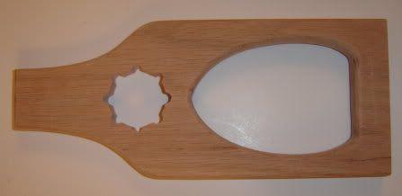

        Curious here about the wine bottle holder - what angle is the bottom cut at so that the bottle counterbalances it - and does the size/shape of the wine bottle make a difference?
        Ian
        Scrolling with a Dewalt 788
          the bottom of holder is cut at a 55 degree angle..
          and I don't think the size or shape makes a differance, it's all in how far you put the neck of the bottle in the hole to make it balance..
          Mrs.Trout said it took her a few minutes to get the bottle right for it to stand up right..
          I'm using 3/4 inch oak on these..

            Thanks, Trout. I'll give it a go with a piece of scrap and make sure the wine bottle has something soft to land on when I test it ....
            Ian
              hey Puzzledmoose...
              this is just one style of the bottle holder...
              Bob was looking for idea's for routers and bits..
              this project uses a 1/4 round over and a 1/4 rabbet bit..
              it will even hold up cheap wine..
