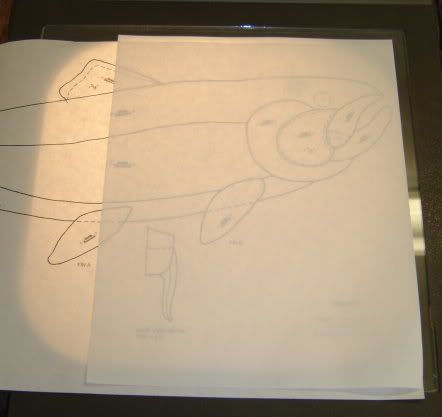

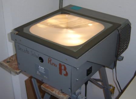

            I wouldn't want to try copying one of those 400 hole patterns this way but here's how I copy my patterns...
            it's an old over head projector, I get about 50 broken ones a year so I've put this one to good use...
            this is the only way to go when your doing Intarsia work...

                If you are not lucky enough to have an overhead lying around, a small light table will work. Try an art supply store or craft store in your area to find one. We have an old end table with glass top and I just put a small lamp under the table to turn it into a light table. You could also make one if you are handy. Build a box with a fluorescent bulb in it and a glass top. Plug it in and you are set to go. Some scanners do not distort and can be used as a copier also. Resizing can then be done with any photo editing program. Steve's suggestion of light pencil marks is a good idea for putting it all back together after printing of 8.5 x11 paper.
