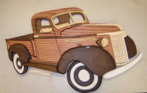

I am soo ready....
  • I am soo ready....
    for this project to be done!
    just a little more work on the front bumper, then to give it some depth
    and then glue together...
    let's not forget that it still needs a steering wheel, maybe I will add the gas cap after all, hinges to the door, the light on the front finder..
    4 weeks and I don't know how many hours, no need to reply because it isn't done yet..
    That's coming together real nice. One of these days I'll work up the nerve to try my hand at intarsia.

      I do have to comment,
      That is soooooo nice. I too must try intarsia someday.
      Nice work, I can't wait to see it finished.

        yes, it looks great. as for gas cap... is that on the passenger side, ? I was thinking on the drivers side. Either way, looks great so far

          this project is sucking up the hours...
          what's taking all the time....
          the front fender is raised 3/8, the grill 1/8, the bumper will be raised 1/2 inch and then slop down to a 1/2, running boards are raised 3/8 and slopes down to 3/4, the bed and rear finder is raise 1/4...the gas cap is raised 3/8 and it goes through 3 different pieces and yes it's on the passenger side of the truck and it all has to be formed to fit together...
          I think I'm at an intermediate level of scroll sawing and this pattern is definitely on the high side of intermediate....
            The grain of the pieces of wood you picked really adds to the 3D effect. Very, very nice work.
            What's the actual size?
            Pete
              Beautiful piece of work, it is nice to see something other than animal intarsia.Is the grill one piece?
              Rolf
                the size is 14 x 22...
                73 peices...
                the grill is one piece of wood, first you raise it 1/8 and then slope it down an 1/8 and then cut it into 13 peices, rounding down the top end of the cuts and then glued back together...the top peice of the grill is raise 1/8 and then slopes down the meet the trim that runs along the hood and cab...

                  Mighty fine work

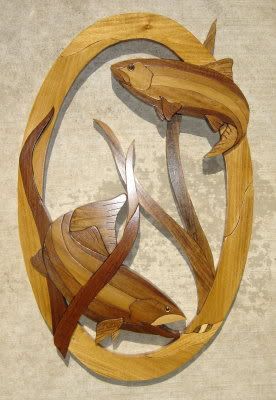

                        Very nice work on the fish
