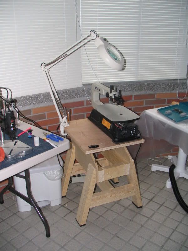

    I live in a 4th floor Apt in Taipei Taiwan. All buildings here are concrete. The concrete floor is probably 8-10 inches thick. So imagine my surprise when the neighbor below said he could hear me scroll sawing.
    So I got some 1/2 inch closed cell foam and some hard rubber pads to isolate the saw from the bench and the bench from the floor. The whole thing felt spongy to me. I was surprised to find that not only did my saw runs quieter, which I expected, but it ran smoother. I have a Makita SJ401, the only decent one I could find over here. But it will have to do until I retire.

      No. Open Cell is the foam rubber that might be used to pad the seat of a chair. Fluffy and soft. Closed cell is heavy and dense. A piece of 1/2 closed cell you might not be able to compress very much with your fingers, maybe only 1/4 inch or so.

          That's how I have mine, on a homemade table. My space is limited. I found the plans from a link on this forum, I think. The craftsman called them the Lazy mans bench, I think because the top will tilt forward. You can see the black foam under the feet and under the saw. I also want to put a glueing drawer under the table but haven't got around to it.

            Oh boy! Your space is the cleanest I've seen. How do you do it? I looked hard for some dust but still couldn't see any!!! I do like the idea of the foam.

              Wow, you have windows for light and your work area is so clean! I am stuck in the basement. I like the rubber idea, will have to see if I can talk hubby into reattaching my saw with some underneath.

                Clean Uh. SWMBO says I have to clean up after each session. That's the same small porch where her washer and dryer reside. Thanks though.

                  I must be blind in one eye and can't see out of the other. You have a very hansom s/saw bench. You did a good job building it. Very nice work. I'm not having much luck in finding the past posted plans you mentioned. Could you please post any plans that you may have? Materials list? Thanks. Tony
                    The Link
                    Here is the link for the scrollsaw bench.
                    There is also a pedal powered saw on the same site.

                      That's the bench. It's really confortable to work from using only a folding chair. I do need to set my stop for the angle down. I set one stop at all the way down, but I think it's too much nose down.
                      With the equipment I have, making those 15 deg and 75 deg cuts was a real challange. Here is the only power saw I had. A table saw with no mitre guage, no height adjustment and no blade angle adjustment. The blade wasn't high enough to cut completely through a 2X4 so all cuts had to be made twice. The long 75 deg cut was made with 2 cuts on the "tablesaw" and finished it off with a hand saw. A job that should have taken a couple of hours with modern tools took two days.
