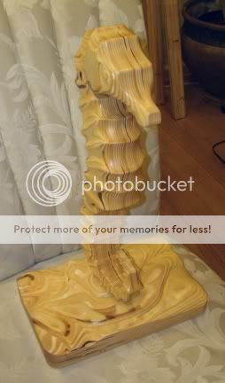

    Another idea for good plywood: it looks great when carved... here is a project I did. I scroll sawed 4 identical seahorses and glued them together, then rotary carved, sanded and finished it. The base is 3 layers of the same, carved with a rotary grinder disc, then sanded and finished. A 5/8" dowel joins the two (without glue so I can rotate it to show its good side and easier to transport).
    BTW, my guess is that good plywood (no voids) would be fine for the collapsible baskets you asked about. With voids, no. My plywood had no voids, but if there was an occasional one, I'd fill with dust from the sanding and then saturate with same finish I was using... I'd expect shrinkage and do it another time or two.
    Spence
