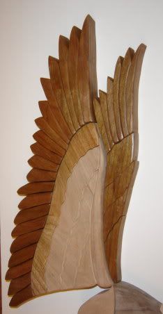

                      I always suggest doing something that catches your eye and not worrying about whether it's a "beginner" pattern or not. If you see something you like, go for it. You'll be much more likely to finish something that you like.
                      This swan was my first (and still only) intarsia piece. I don't think it would be considered a beginner piece but that didn't stop me from hacking it up. It caught my eye enough to want to give it a try. Intarsia's not too tough, just very tedious with lots of sanding and finishing. If you like that sort of thing you can get some very beautiful pieces. I will say though, that after doing the swan, I went back to fretwork.
