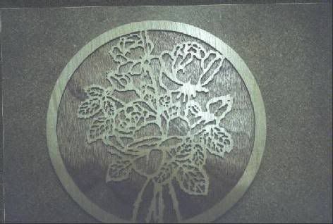

                        Well JT there is no disputing the quality of your work.
                        I will also say my work has all been done on low end saws.
                        This piece was done on a 16"VS Delta sitting on top of a bench with no clamps
                        The entire vase of roses is one cut. lots of backing up, but one continuous line.
                        All saws do vibrate, unless they are turned off
                        If they didn't vibrate then the blade wouldnt move.
                        If you want to reduce vibration, increas the mass of the saw itself, not the mass of the moving parts.
                        Although the quality of a saw will make scrolling easier, price does not equate quality and a good workman never blames his tools.
