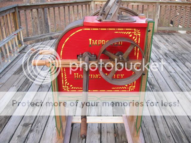

    Some of you may remember that I did a complete restoration of a 1900 Hocking Valley cornsheller last year. That was a very interesting and challenging project and I enjoyed bringing back a little bit of history with the restoration. I did a video of the operation of the corn sheller and have received lots of comments from folks asking about the project. I recently received an e-mail from a gentleman in Mississippi who is interested in having me restore his cornsheller.
    This is a Hocking Valley Improved 2-hole sheller made in the 1930’s. A little different but basically the same as far as the mechanics . Back in the 1930’s this unit sold for $95 and weighs 225 lbs. I asked the client for a little history about the cornsheller so here is the story:

    So he loaded it up on a pallet and sent it to me .As you can see, there's not much to work with .
    I used white oak for the restoration. I even got to do a little scrolling to do the cut-outs for the bearings and the cut-out for the top.
    Woodworking complete
    I had to make new stencils for the lettering and hand painted all of the pin striping just like the original Hocking Valley.
    And here is the restored Hocking Valley Cornsheller ready for action
    If anyone is interested in seeing this unit in action I did a video which can be seen by following this link:
    1930 Hocking Valley Cornsheller Restoration- complete.WMV - YouTube
    This was a fun project

    Wow you certainly didn't have lots of parts to start with...another fine er I mean a sweeeeet fine job Mike. Thanks for posting those photos. You have the ability to make memories for those people come alive. Good for you. Thanks for that video, wondering if there was a machine to peel the husks first, or did they do that by hand?

            To WD-- I'm sure that they had some kind of equipment to shuck the corn but that is another story LOL.
            To Rolf-- Don't know about a reality show but I did get an article in Farm Collector Magazine of the restoration. Fun Stuff!!!
